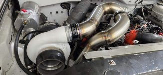

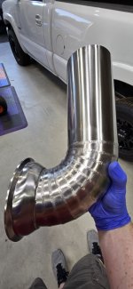

View attachment 124597View attachment 124598After talking about it…. We decided to get rid of the last v band and just go all vibrant… titanium air intake and a new stainless stack are pretty much all that’s left…
Looks amazing man! I love those hd clamps. They sell them now as a combination aluminum/stainless so you don't have to buy the separate kits too, which is nice. I've been trying to figure out a heat sink that clamps to the ferrules like I have for regular v bands to help keep the stainless from warping. If you could , ask your buddy there if he has any way he does it, or does he just weld them? Sure would be a shame to warp a $150 flange! Can't wait to see the titanium intake, that'll look KILLER! but now , you have to leave the bare stainless to match it......

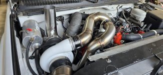

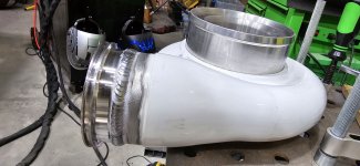

View attachment 125227View attachment 125228View attachment 125229View attachment 125230
Very close to being done intake just needs welded up and the flange for the maf sensor needs finished up.
Looks great man! I still think you should of left the stainless bare .... But I gotta admit the white looks killer! Is the hood stack stainless or titanium? What do you need for a maf sensor flange? I can make one for you if necessary on my mill, I made mine and my Map sensor flange. Of course, im sure your buddy there has the capabilities as well , just throwing it out there anyways. Can't wait to hear that thing in action, you gotta post a start up video!
