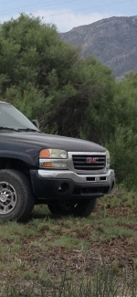

1500 mod here. Make brackets for the frame horn, redrill holes for the outside brackets up 2” and either 1500 grill or cut the plastic piece off. I cut mine off. Tow hooks and fogs have to go too if you still got them.

I know tow hooks can't stay without cutting the lower valence, but fog lights should be bolted to the bumper. Why do you have to remove them?

Fogs can stay. Tow hooks can be done if you use the GMT-900 hooks.

Looks like they can stay. The just clear the body mount. I could have sworn I couldn’t put mine back on and replaced I them with rigid duallies.
