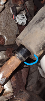

Heck, that small amount its off could be attributed to the rust flaking off that end. Id replace it just to be safe, though.

I've got bellow at both ends of mine.. I defused a lot of leveraged force to get it off

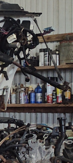

Couple pic from Christmas weekend also zoomed in steering shaft .. seams they changed stuff.. fancy that.. hopefully I Didn't compress the steering column.
Edit I see I already posted a couple .
Edit #2 mine is identical to the dorkman 425-131 version

The 4125-176 is the part inside that connects to the column and extends out side and connects to the 435-121 version.
It's collapsible.
2,603
1,117
176 is the part that goes through the firewall. Got it.
Wonder how involved that will be. it didn't "collapse" easily and most definitely not going to "extended" easily
Yes, That's the collapsable part in case of a severe accident to keep the column out of your chest like the old cars...
The Borgeson replacement I have here is also stiff and requires alot of force to extend and collapse it.
I'm familiar with the functionality of the stuff. Just figured it was the part in the engine bay due to how easy one can bend the bellows

Are you done playing with your shaft yet??? 🤣
Here is one all the way compressed and extended for future reference.
Reactions: malibu795

😂 Yeah, steering shaft is reconnected, used a ratchet strap and a hammer to get it extended..
