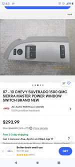

Got doors home, I've got the tan bale connectors in my truck but not the purple center connectors. I've done some digging but not through looking for them.
DS has two PS has one connector.. which I got no idea what they control, keyless entry maybe?
DS need inner door panel and master switch with bezel.

Can you do a better picture of the connectors so I can see the wire colors. Maybe I can find them in the schematics.
Another possibility, is the two doors from different audio options like luxury, bose or basic?

I couldn't find any exact matches in the diagrams but it did look like there was some difference if the mirrors where heated, and had turn indicators. Also for the auto windows, and audio system. But couldn't find any concrete schematics that had the same color wires with the same type of connectors

07 and 08 are like bastard years on those trucks...
Any way, I think that's an AN3/ DL3 optioned truck. What looks like Orange I believe is actually supposed to be red. My dad has an 07 and remember having this issue trying to follow the factory manual when diagnosing the switch for the window not going up and down.
And FWIW a brand new switch has to be programed with GDS in order for it to work...
