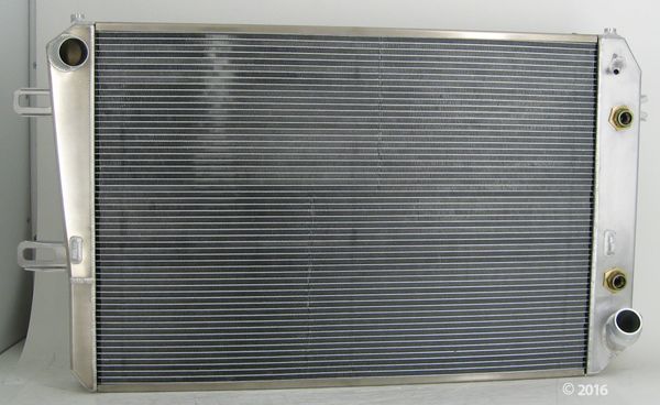

Won’t be enough still. I did an aux radiator before I sold it and that made a bigger difference for the same cost as the lbz change.

Yup. As a nice comparison, the Ron Davis radiator alone made a difference over stock as I was heavier and more power than the lbz I was towing with and I was always 5-10* cooler than the lbz (this lbz is tuned, solid fan hub and extremely well taken care of maintenance wise)

Ok, thanks for the info. I wanted to see if Ron Davis could make an LBZ radiator for me. I have the parts to do the swap and almost enough parts for a second swap.

I was told by Ron to contact this guy to get one of his radiators for the 06-10 trucks.
I wasn't aware he sold the Radiators too. I though it was just the AUX kit
$2400 😱
