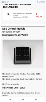

Looks like I'll have to replace the abs pump module as well. Good thing everything is fresh 🤣
