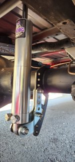

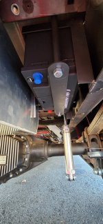

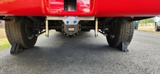

A few better picks of the work I had done.
Firepunk makes the adjustable brackets for the derale trans coolers. Tim McAmis push/pull style power disconnect showed up last week, so that will be replacing the current one.

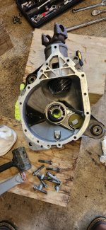

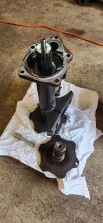

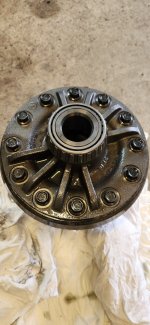

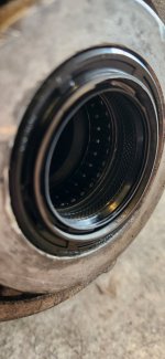

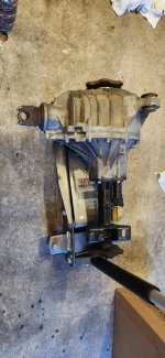

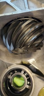

Decided what better time then now to pull the front axle out and fix the leaking axle seals and the case half. Once I got it torn down, I proceeded to clean all the mating surfaces real good, then the process of getting it all put back together. Wasn't that bad of a job, but could of been better if I had an impact gun and a nice bench to work on it, instead of the concentrate garage floor 🤣
