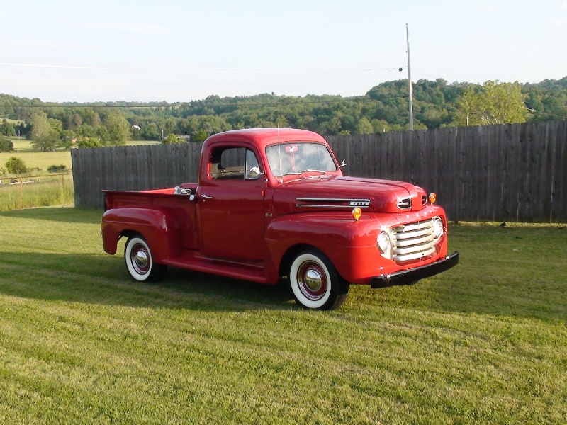

Had to give a little attention to another vehicle this summer as well... letting them sit around too long caused the need for a lot of maintenance.
I know it isn't a diesel or a GM, but been having some fun with it.

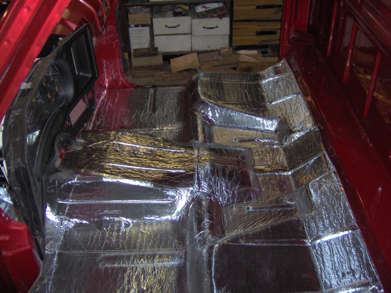

Added some MegaMat to quiet the noise. It really hurt to cover my nice paint....

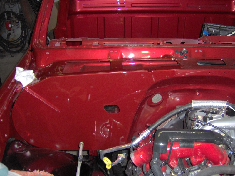

Got the firewall plate permanently installed.
