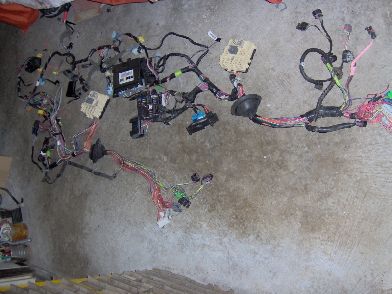

The last project was extending the wiring harness for the truck to relocate the fuse box & run all the wiring in the fender. Only about 110 wires in the dash harness...

Here is a pic of the harness.
Cut & spliced 2 harnesses together to make it longer. It is now routed through the fender to the left front corner from under the dash. Trying to hide all the wiring as much as possible. I modified the factory fuse box to fit under the hood. Now if I could find some time to work on it....

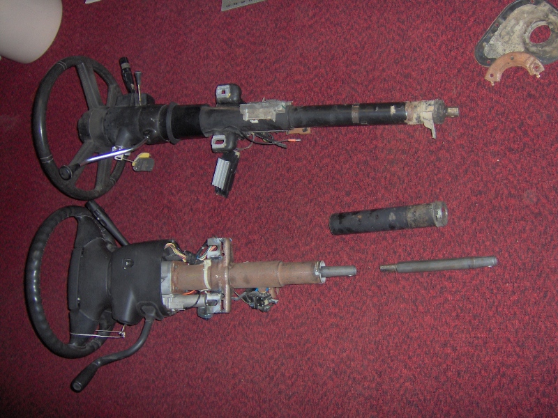

I really only bumped it because I read through the entire thing again looking for something (how you attached the steering column) but looks like thats the next step?
I'm hoping to not run the new steering column but rather figure out how to shift the allison with a sq body auto column shifter. Or maybe reshape a new shift lever to mount to the oe column? IDK yet. Just one of the things on my mind lately. ;)

Actually I mounted the new column with the existing mounting holes to the old dash rods/brackets. Note how they are aligned in the picture.
Using the new column allows the trans shift cable to be easily used & the detents are in the correct place. Not sure how easy the old column would be to get the detents correct.
