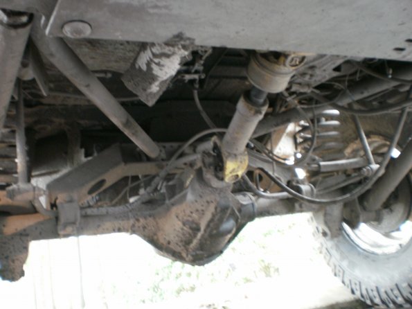

However, as some have pointed out, the extra parts tend to make them more prone to breaking. My personal experice is different as the driveline angles I am forced to fight with are much more extreem on my Jeep. I have had great luck with driveshafts custom made by Tom Woods.
I don't have a great picture, but here is the best one I have...
And how about a show of stregnth... Was trying to climb some culverts, and the rear end had too much traction. I was in 4low, second gear on the red line, heard a pop. The components involved were the Tom Woods shaft, cromemolly D44 shafts, a rubicon carrier, and stock ring and pinion. I sheared the pinion off and broke the carrier.

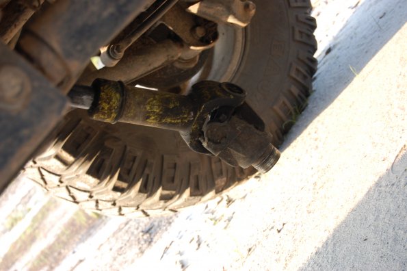

A couple pics of the carnage
Thanks for warning me about this shaft! I think you saved me from bigger damage. I finished my driveshaft loop last Friday, went to the dragraces on Sunday, first run was fine, but when I was building boost at the line on my second run: boom :( the damn shaft snaped just like yours. Glad I had my safety loop installed.
Will post some pics later...
