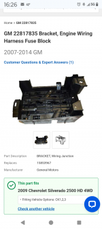

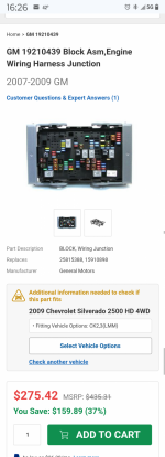

Called around, Hicksville has these for ~130.. local yard is +/+20 of that.. seams there are 2 variations of the diesel version.
Going to order some DMM probe kits to get into the connectors to test circuits easier

I'm not sure, someone can probably compare the part numbers, but I believe the gasoline Silverado, Sierra, Tahoe, suburban, etc all used the same fuse block. Just populated the fuses differently. I'm seeing those for far less then the "diesel" ones
