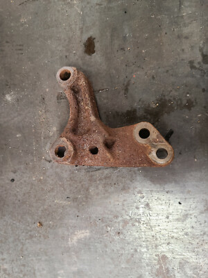

I think this is the bracket that goes on the back to support the EGR cooler
Awesome. Thanks. I saved it in my watch list. Saved a handful of EGR actuators and coolers. Some listings say it fits LBZ and LMM. Any idea if that's true? Would open up possible vehicles near me that are being parted out

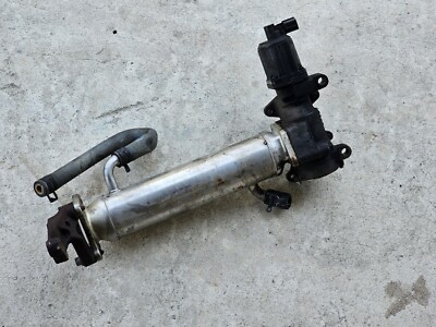

So I assume this part is from the late LLY that is actually an LBZ since it has a grid heater
And this part is for a true LLY?

Lly grid heater = Lbz for sure. I’ll be losing my EGR but I believe the Kodiak pipe is different. I’ll snap a pick. I can also get you a clear pic of the up pipe if needed.

So this is the LLY EGR like the one my 05 has.
It's hard to get a clear picture on the engine because the coolant tube is in the way. But the pink tag looks the same and has the same part number. Serial number is obviously different.
