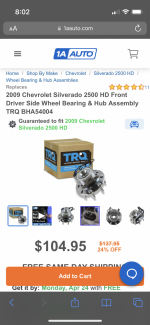

Front Drivers side hub is going out. Found a brand on the internet…but it is a lot cheaper than an AC Delco Replacement. I know cheaper is not always better but sometimes it works just fine. Anyone ever used this brand? Or do they recommend another brand?

Go ahead. When you come back in a few months asking why it failed, well......you can do the job the right way, or do it twice.
Timken are on my truck, but they are older style, and even Timken quality is suspect nowadays. I use SKF or AC Delco on our cars.
TRQ is pure junk parts. I shake my head every single time I deliver one of those boxes to a customer. If one of my kids brought those parts to me, I would refuse to install them.

That’s how I figured it would be. I found Detroit Axle brand hubs. Those any good. I had never heard of the brand I posted until when I looked em up but I figured with a price tag like that they have to be junk. I know Kryptonite makes good front end parts for these trucks and they have a front hub. Thought about buying those. Just going to keep looking around. Will probably go with AC Delco but I have heard good things about Detroit Axle but don’t know if the hubs are good.

Detroit Axle is TRQ. Same thing. Cheap crap.

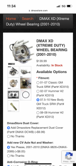

DMax store has them. I just want to go with a brand i truest. Some of the AC Delco stuff I haven’t been a fan of lately. I always like DMax stores parts. Anyone tried these?

Thing is, NAPA hubs are SKF.
yes i know. thats why i listed the three mfg i feel are the best and then said to get the ones with the best warranty because regardless, you are probably going to be using it

Just go with kryptonite, they offer the lifetime warranty or will it not apply to the bearing?
the problem with dmax store is the "sit and wait". they want the old one back before warrantying it and its up to their discrecion. with a box store unit, it usually as simple as "walk in, exchange, walk out".
Ya that's an issue. Even if I wasn't using my truck to dd I'm not going to sit around for a few weeks waiting.
That being said I put new SKFs in about 5 years ago. Still working alright.
2,195
815
When I called Kryptonite, It didn't seem like an issue to warranty stuff as long as it is registered or you have proof of purchase from an Authorized dealer. Bdsankey would probably know better since he is a Dealer.
Yes you have to send it in first because they need to claim it back. In the past people would call for a warranty and never return the bad stuff.

I bought TRQ hubs for mine from 1Aauto back in 2016. Still on there and no noise, I figured for $150/pair why not try. Lifetime warranty
