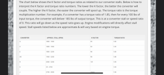

The DK confuses the hell out me. Mike said it was made because they had supply issues making the R and it’s my understanding that it’s supposed to mirror the R’s specs, but they went about it differently. Looking at the data from Goerend, they are night and day. Of course Goerend’s data is based on 500ftlbs. I think Dave needs to set up a fleet of loaner trucks to try every possible combination 🤣
6,386
1,750
If that chart Adam posted above holds any water, I think one would be hard pressed to tell the DL, X, DX and G apart from each other. The other three are probably enough difference that they are noticable but not those four. Maybe double the torque and test again and see how the chart looks

Low stall but high multiplication on the X. Interesting. That backs up what Josh said about the X coupling hard. It isn’t typical to have high multiplication on a low stall converter. It kinda confuses me a little more than I am already.
I’m still of the opinion that I should eat a bowl of alphabet soup and whatever letter is left in the bottom wins.
Generally low stall means it fluid coupling happens sooner.
There is also the difference between from a stop and while moving.
I went round and round with Mike L, years ago, trying to pin down clear definitions, pretty much just pissed him off about it
Seams goerend got some basic stuff written down which makes for common ground
Reactions: N2BRK and 2004LB7
