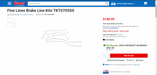

Not sure how much you value your time, but I'd just grab a stainless brake line set
I haven't found a set for the 09-10 trucks, YET, I do know they ran 2-5/16 from MC to ABS and 4-1/4 from ABS to wheel.
Stringing lines would be really quick with nothing on the frame

The 07-10 trucks went to 4 channel ABS vs older is 3 channel. So instead one line to the rear and split in the axle there's 2 lines to the rear axle

So if I called you a liar, Would you be upset??? :ROFLMAO:
Nah, I know pictures is wrong out the gate though, most likely just a "stock picture that doesn't accurately represent said product"
I've seen enough nuance difference in the platforms to question finer details..
Example for 01-10 trucks there are 4 different engine options... Fleece and I found out there actually 7-8 different blocks not counting the Kodiak stuff.
My 07.5 LMM has 2 engine coolant temp sensors in the the T-stat housing. Most only have 1 sensor
Summit's Ohio store is ~2.5hr drive for me. I'm sure I'll be making I drive up there.
Not saying they don't make a set, definitely worth few phone calls at a minimum
I put in as an 09 2500HD WT model. also selected the Ext cab option. the only issue I see according to the fitment is they list it fitting both Extended cab and Crew cab options with the 6 1/2 ft bed.
Gotcha, appreciate it.
