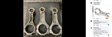

I found this, is this what you are referring to?

Is the one on the left the old design? Looks slightly thicher and stronger than the one on the right. How's the thickness of the internal web between the two?
