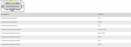

It's a GM part. Where is the other end of the plug located? Does it go straight to TCM? Does someone have a schematic or can point me in the direction? Hard to meter wiring without knowing what's what.

Here is a little more info on the operation of the NSBU switch:
NSBU Switch Range Chart
RangeABCP
POFFONONOFF
ROFFOFFONON
NONOFFONOFF
DONOFFOFFON
3OFFOFFOFFOFF
2OFFONOFFON
1ONONOFFOFF

It's looks like that's the pinout for 01-04(2 plug) , which is awesome, but I need 04.5-05(single plug). Is the tcm plug pinout also different between the two?

If the TCM C2 pinout is the same 01-05 then I can use that with the LLY Engine Controls schem. that 2004LB7 posted.

At first I thought this was gibberish lol, then I looked harder and separated it out
Given that D321 are all messed up, I'm guessing the issue will be on "C"

Sorry, for some reason I thought you were working on an LB7. Maybe when you mentioned your early TCM, it got me mixed up. Here's a pinout for the newer style LLY NSBU.
  • LLY nsbu connector pinout.pdf
