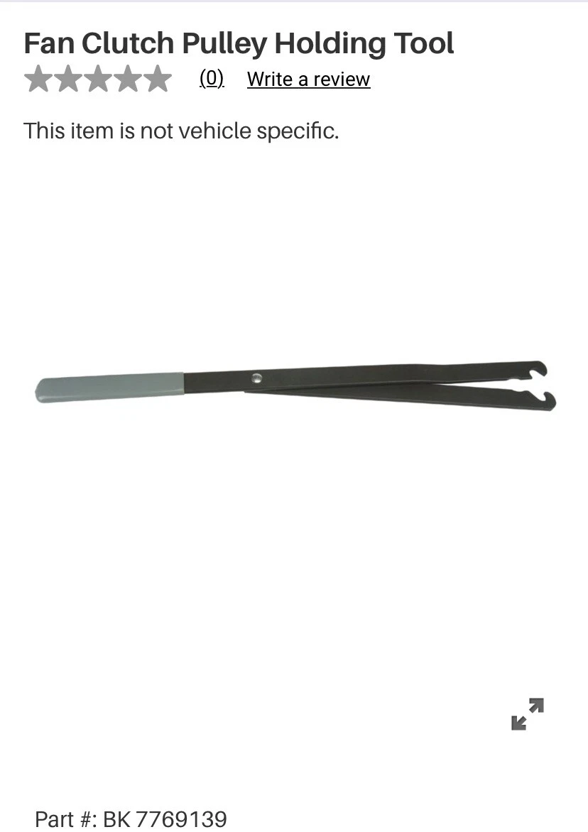

7,104
2,207
I made a tool out of two pieces of flat bar and some pins to hold the fan pulley. Was much easier then chiseling it or banging on it with a hammer.
Not too much different then this one. But instead of hooks I added pins to fit into the holes in the pulley
Reactions: malibu795

I borrowed a tool similar to that from the parts store, along with the required 48mm clutch wrench. I just stuck two short bolts into the pin holes and grabbed those with the hooks. I couldn't pull hard enough on my improvised pins to get anywhere, but I was able to brace it against the AC compressor and use a hammer on the 48mm clutch wrench to get enough impact to jostle it free. That is, after some heat and PB blaster.
I'm hoping I put it on with enough grease on the threads to make future removals easier.

7,104
2,207
All that said, the giant slots in Malibu's pulley intrigued me.
I put mine back on with Anti-seize. I had to remove it again a year or two later and it came off easy. The engine turns in the direction that tightens it so I didn't worry about it coming loose

2,600
1,117
like this tool?

7,104
2,207
Very similar. The attachment point or that little pivot I put right near the top so it was taller and can open up more. Same idea though.
I welded in the pins too. Very basic easy to make tool.
The chisel and air hammer was messing up the nut pretty bad. The fan pulley was also just slipping on the belt. The tool and a wrench and it popped off with little effort
