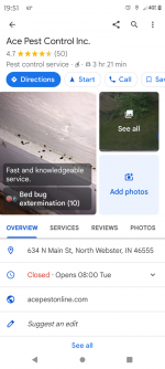

Roni would kill for a car like that. An early Mustang or 78-87 El Camino. Yeah, she's "eclectic". :LOL:
Maybe spend your money...
Ace pest control has some old fleet el caminos they may part with.. driven buy there few time to make deliveries in the area
