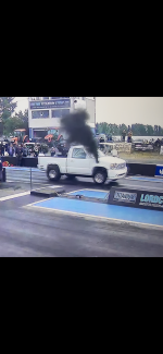

So since you all have nothing better to do I thought I’d make a post about my poor old lbz. I bought the truck January 26 2018 as a stock regular cab long box 2006 lbz with 365,000kms 226,000 miles
With plans of making it a race truck I bought a pack of grinder blades and went at it.
IMG_4118.jpeg I cut the frame to make it a super short box gutted the bed and added front coil over kit.
And a set of caltracs
I think it was stock fuel with a drop in 72mm vgt and dual stock cp3’s
On stock transmission I did a 11.7
This truck has raced every year and has had its share of issues. been upgraded slowly to what it is today.

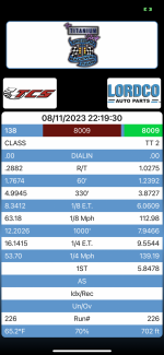

Fuel only currently it went a best of 9.85 at 140mph in the 1/4
Then Friday I decided I’d had enough and sprayed it with a .073 jet and that seemed to help the 60’ enough were my bad driving and short shifting didn’t matter and set the new stock bottom end 1/4 mile record.

I think the truck has a 5.80 in it and a 8.90 with a little better track prep and driving.

Well blew it up good spun 3 mains bearings and cracked a piston. Also put oil all over the track as it blew the rear main seal out. But it’s the end of the season here and have plans on making a whole new thread on the new build as the truck sold as a roller. Truck did still do a 9.85 with a 1.55 60’ at 137mph spinning on its own oil through the traps.
