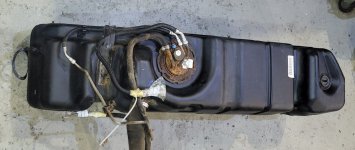

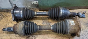

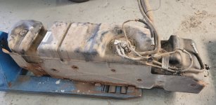

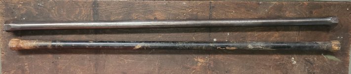

Time to go on with the Sierra
Start with cleaning and collecting all we need for the front axle
Differential and Tank is back from power washing
starting cleaning torsionbars
the front diff need some more "love" i guess....
we will see what is also necessary as just some bushing, gaskets and bolts...
