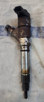

Got the Engine home Saturday
and start disambling Sunday
we could notice until now:
EGR seems to be worse or is it normal that this amount on oily deposit is in it
The Turbo run free but have a minimal radial movement
The injectors on the driverside come out without problems
Injector of Cyl 7 shown a little bit heat-markings
We run out of time so that we must stop and the passengerside must wait also the injectorpump
First we need to buy special sockets we didnt have in our toolbox for the exhaust bolts
The engine wasnt ever touched, we find a lot of paintmarkings from the assembling.
The heads are really dry like the enginebuilder said. Only the oilpan is a little bit leaky
And since we are disambling this engine for the first time, we have also documented everything with lots of pictures. There are no instructions anywhere on how the electrics are laid out in detail at the end.

The deposits from the EGR look pretty normal. The soot from the EGR won't build up much, but if oil vapor from the PCV is also coming in to the intake, soot will stick to that and build up thicker over time.
If you do a PCV reroute it will help prevent future buildup, if that is legal in your area. Or at least a catch can will help.
