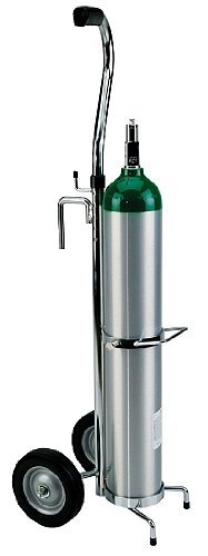

And a picture of the oxygen E tank. For those not experienced with it. They stand around 25" tall and about 4.5" wide

I’m sure you can find a nitrous tank that’s similar sized. That way you won’t have trouble filling it.
