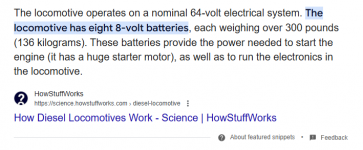

Also, the batteries on a locomotive are there only to start the diesel and run the basic electronics. Nothing to do with the main drive system. Dean
Reactions: 2004LB7
7,099
2,205
Yep
The output of the generator on the other hand I think is in the range of 480 to 600 volts. Apparently one was used one to power a small town. I still haven't figured out how voltage and frequency matched up so perfectly unless they also use 480v 60Hz 3 phase as a standard.
