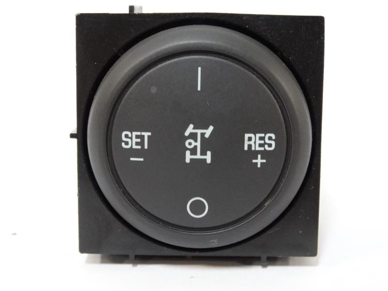

5. Can you enable the 4wd light to come on in the IC like the manual Tcase trucks get? Hate that it's only the light on the knob.
As Ben stated, this is controlled by the cluster programming. The short answer is yes it can be done. Just need the proper calibration file and hardware to program it with.
