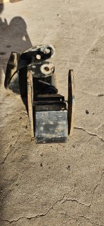

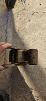

While I'm waiting for my new rear leaf springs to come in I decided to look at the sulastic shackles I put in about 30k miles ago....
For the $400 I'm not sure these were even worth it.
Should I junk these and just get stock replacements?

Weather is +30 Celsius in the summer and down to -30 Celisus in the winter. I've never even pulled a trailer since these have been on, just a slip tank with fuel in the box sometimes. I'm guessing the bushing seized to the pin and tore the rubber.

its suppose to be connected since its a rubber bushing. thats just flat worn out. up to you but i wouldnt drop the cash on new ones. the cold weather isnt being nice to it
I agree, if they were decently priced I'd replace them but I can get stock moog ones for 1/5th of what these cost. In the garbage they will go. I sent Sulastic an email but I doubt anything with come of it.
If anyone is wondering if they are worth it.....the harshness felt on your ass paying for these isn't paid back in ride comfort haha.

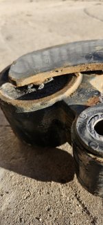

I took off my sulastic shackles today and put stockers on. These ones were replaced under warranty and have been on for less than 18 months now.
My truck was dog tracking and I looked sure enough one side failed completely, these even caused my leaf springs which were brand new dorman replacements to bend a little clockwise making it difficult to bolt the stock shackles back in. I've towed nothing, only usually have a 120230411_183447.jpg20230411_183605.jpg20230411_183623.jpg00 gallon slip tank In the rear. I will not be going for replacement under warranty.
Sulastic shackles are junk.
My truck was dog tracking and I looked sure enough one side failed completely, these even caused my leaf springs which were brand new dorman replacements to bend a little clockwise making it difficult to bolt the stock shackles back in. I've towed nothing, only usually have a 1View attachment 114238View attachment 114239View attachment 11424000 gallon slip tank In the rear. I will not be going for replacement under warranty.
I had the exact same thing happen to mine. Said screw it and put them on the scrape pile. I think in the south where they dont see the corrosion they might last better. Edit: I see i posted on this thread before so you can see that comment as well.
Pure junk, I can't see these lasting if you were to tow heavy. I'm pissed they cause my leaf springs to bend clockwise, not sure if I should replace the springs again.
