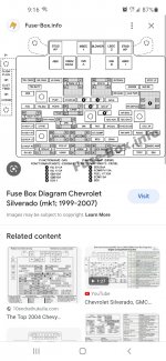

So in that case if I got 12v in all other fuses an just 3v on the 2 circled I would have a bad fuse box

When you have 12V on one part of a circuit but only 3V in another part, my first thought is high resistance. I think James is right.
Check the voltage on each side of each fuse. They should be the same. Then pull the fuses that have 3V on them and see if they are making good contact. Clean them with contact cleaner, brake cleaner, etc. Sometimes pulling and replacing make a difference. It looks like there is corrosion in that fuse box. My wiring diagram shows 2 -15 A fuses and a 10, not a 15, 25, and 10. Look on the underside of your fusebox cover and see what the names of the problem fuses are.

That was a pic of a fuse box I had on my phone to use to show which fuses the one in it has been cleaned will try check again tomorrow when I get back in the shop

Look at the UNDERSIDE OF THE LID to see what the NAMES of your problem fuses are. Just having a picture does not tell us what they are and therefore what circuit they feed.

Here's a diagram of it an its fuse 1 an 2
