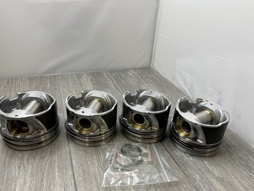

I pulled apart the parts engine and fount it had Mahle pistons one was holed and another had a crack starting. I thought Mahle was the best but the ones in this engine were cracked. I think I read they changed the piston pin design and also wanted to see a pic of the oil ring land and piston pin distance between the 2. Thanks

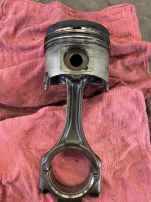

What are you seeing that makes you think they’re Mahle pistons? They look just like every LMM piston I’ve seen. Here’s a pic of one I pulled out of an 07.
Reactions: 2004LB7
2,190
812
Here is a used LB7 piston. Does this answer your question?
For the LBZ/LMM they redesigned the piston and added a pin bushing to the piston. But they also went to a different manufacture to make them.

JoshH, no honestly I am not, this is my first DMax, but the one side says 3851 the other side is 3451 which when I looked the number, it came up with Mahle pistons and they have the coated skirts.

Thanks 1FastBrick, I was trying to see if there was a major difference in the distance between the ring and the pin, maybe due to compression difference. I wonder if these aren't Mahle pistions which would be better, the delipped LB7 or the Mahle non-forged?
2,190
812
The Coated skirts is standard on the LBZ and up when they changed piston manufactures.
The Duramax pistons are directional I believe because of the oil squirt location and possibly pin offset. You have right bank and left bank pistons.
21,145
4,903
Mahle pistons came factory in the LBZ/LMM. they are a very weak design and commonly crack where yours have. Mahle does make a race cast piston that is stronger than the stock LBZ/LMM and debatable if they are stronger than a stock new LB7/LLY piston thats been delipped.
