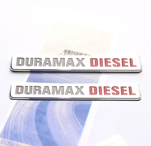

I'm assuming a heat gun and decal remover wheel is the best method to remove them? I would like to reuse them if possible. If not has anybody had any experience with the aftermarket badges? There aren't as many aftermarket options as I would have thought for the 2500 badge and it's hard to tell how the quality is. DHD carries the classic duramax badge but not the old style 2500hd badge...
