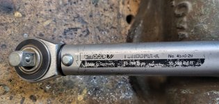

To disambling the Front axle will be take more time as expected
All is sticky
Finally it killed my 35 years old Gedore Torque wrench 😋
I want already buy a new one since some years only waiting the old one failure

Just a word of advice.
A torque wrench should not be used to break bolts loose. It will throw off the accuracy in the long term.
Not to mention it can break it just as you have done here.
You need to use a breaker bar when breaking things loose with high torque values. They are designed for high leverage and also much less expensive to replace if it were to break and not have a warranty.
Reactions: Phoenix-LH

he was overdue for replacement but your advice is wise and also known to us.
But since others who do not know that may also read here and then draw wrong conclusions ...
So 1Fastbrick is absolutely right who wants to scrap his torque wrench solves screws with them - so dont do this
Reactions: 1FastBrick
