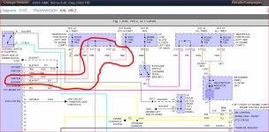

In the fuse panel on the left of the dash. With Fuse IGN 0 in there is zero communication. This fuse is one of many supplying power to the ECM and TCM. If I remove it or unplug the TCM connector with this wire I can talk with the other modules.
With the fuse removed I get 12v on the hot side and 1.3v on the wire supplying to each module. I've tested the wires coming out of the dash fuse box, in to the under hood fuse box. Back probed C1-E11&F12 as well as back probed into the ECM #4 wire 1020, down to the TCM plug. All have the same 1.3V.
I've checked/cleaned down to fresh metal all the engine grounds and chassis to body grounds. I've unplugged the harness on the back of the trains with the same result. I unplugged the NSBU switch and got 1.3v on every pin except for the 12v from the ECM.
I've tested the Mil feed at the tcm and got 12 volts (unplugged).
Here is the kicker. Ive done all of this with a new TCM as well and got the same result.
I'm figuring it's a power to ground some place but am struggling to locate.
Every module in the cab is unplugged. I've separated the wiring harness from the under hood fuse box to each module plug and cannot see anything obvious. BTW the J1939 is 60ohms.

I'm not sure I follow. What wire/pin are you not expecting the 1.3 volts and are getting it. What voltage are you expecting you should have?
6,385
1,746
Did you separate the circuit to see which wire is supplying this 1.3 volts? Have you pulled the connector block from the underside of the fuse panel and tested there?
So i have not pulled either of the fuse boxes apart yet. The 1020 wire comes out of the underhood box at C2-f11 I believe then is factory spliced in the harness to the ecm and tcm.
I'm puzzled as to where the 1.3v is coming from and why it's affecting the class 2 communication.
6,385
1,746
1020 is a circuit and not just one wire. I'd pull the block connector off the fuse box and probe that to see if you still have 1.3 volts. Also, how do you know the 1.3 volts on the ignition circuit is affecting the class 2 comms? How do you know they are related?
When i pull the ign0 fuse from the left side dash fuse box and use my power prob the ign side going to the fuse has 12v, the other side going to the under hood fuse box has the 1.3v. This is with key on engine off. With the fuse in i have no communication to anything. With it out i have communication to everything but the tcm. The ecm shows a p0700 and loss of communication to the tcm.
