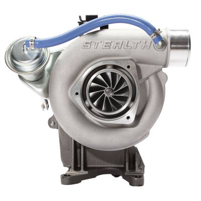

I'd do a drop in for now since you were already thinking about doing one and then in the future if you can't install the compound kit sell it. DT says they are pursuing E.O. certification as well for their turbos .
Reactions: N2BRK
2,210
824
The DT Mach 1 turbo Appears to be 49 state legal already. Looks like they had it tested at Sema Garage.
