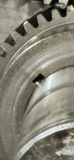

I am 100% certain of that. I had the oil/water pump drive gear off. I could see the pin sticking up in the slot on the crank timing gear.....
But I just looked at photos and this looks suspect to me. I know I looked hard at this, but I did not pull the timing gears off.
Looks like I need to dig back in to the front of the engine.

The easiest way to tell if the gear has spun is make sure the key slot in the gear is still in line with the pin for the balancer.

The bad thing? I noticed this when I first did the repair. I thought it was supposed to be this way. The good news is that it hasn't moved anymore. I'm optimistic that I have no bent valves.
Now to figure out how to get this gear off with a sheared pin in place🥴.

I can not get this gear off. I have about .045" behind the gear and the block. I made a puller, but not able to get this gear to budge. I'm either going to cut it off carefully or weld some bolts to the front of it and pull against those.

So, what are my chances I have bent valves? I drove this with the crank gear in this position or very close to it. This does explain why it was very sluggish, but I didn't get on it much being a fresh build. I would guess that the cam is about 25-30° retarded.
I'll try some heat, then pull.

You can get it off if you heat the gear. I've done it before.
Being that the valves are perpendicular to the piston, it is more likely that you bent push rods than bent valves if it was far enough out for valve to piston contact. I would pull the valve covers and check valve clearance before you put it all back together.

Back together.... certainly have some noise in the heads. I'll pull valve covers to take a look.
I got lucky and the gear had stopped in a position that was at the right spot to skip 5 teeth.... So 40°. Not sure how it would even fire up. So, the crank gear is remarked and it is welded.
But, I have no codes shown!
I'll have a hard time believing it doesn't have bent valves. But only way to know is to dig in to it. Will probably do a compression test first. That will tell me if the valves are bent or not.
