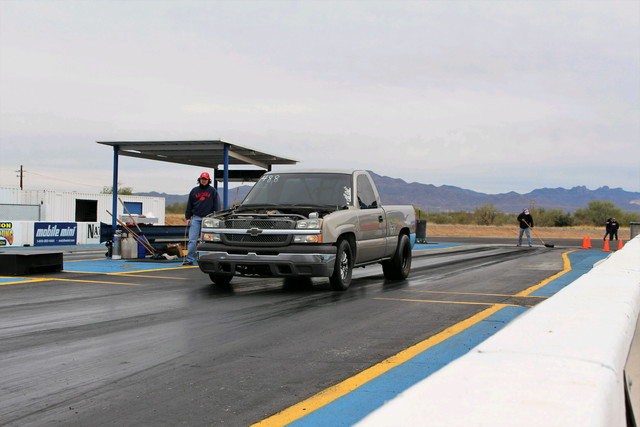

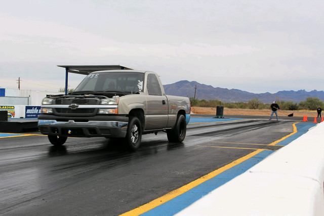

Out of injector... Currently has 160lb injectors, stepping up to 240lb sticks. Lightening up the nose as much as I can to help, the truck is 3610lbs with me in the seat. This diesel spec'd SXE88mm Borg is showing no signs of running out of steam.
