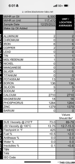

Oo shit. Didn’t see this thread lol. I had the oil checked from blackstone at the end of 2022. Everything came back great, having 115k on the odometer. I plan on doing it again soon. On the next oil change. It’s nice for me to have as much knowledge as I can. So I can at least have an idea of what’s going on in the engine.

My '96 Impala is about to get an oil change and that will get analyzed. I am going on 2 years with the same oil. Only like 2k miles at the most.
