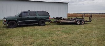

picked up a '05 ECSB 4*4 frame tonight, wanted a ECLB but more involved to swap to that and get running

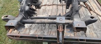

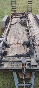

Repairing the 09 LMM I bought end of February this year then wrecked it ~3 week later..
That sums up pretty much all the differences. Don't worry much about the year, find the cleanest one you can and run with it.
Seams I just need to cut the top part off and drill holes and add gusset in the frame horn and it will be pretty close..
I plan on running a DIY bumper from MOVE so any differences is kinda a mute point

Move bumper makes it even easier. Cut off the 01-07 mount entirely and make that new frame horn look like the lmm one. The LMM mounts bolt on and come as a kit with everything needed.

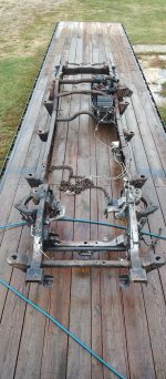

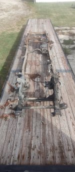

Well cleaned most of anything lose off,
Then forgot temps are dropping below 60° non insulated shop makes it an issue painting. Might let it flash rust the POR-15 it in the spring...

Cheap oven cleaner takes that coating right off.
On another note, since you washed the loose stuff off you could just order the factory frame wax called nox rust from daubert chemical, spray it and get it back on the road.
