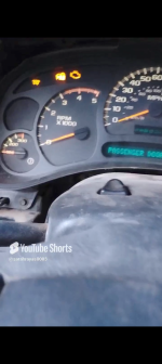

Ok still working on this haven't tried to start it just yet yes I got new wiring harness actually not new from salvage yard tested me glow plugs tested my injectors looking at my timing to make sure they are lined up

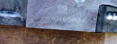

BTW was curious about what year model engine I have how do I know what the correct engine code is
