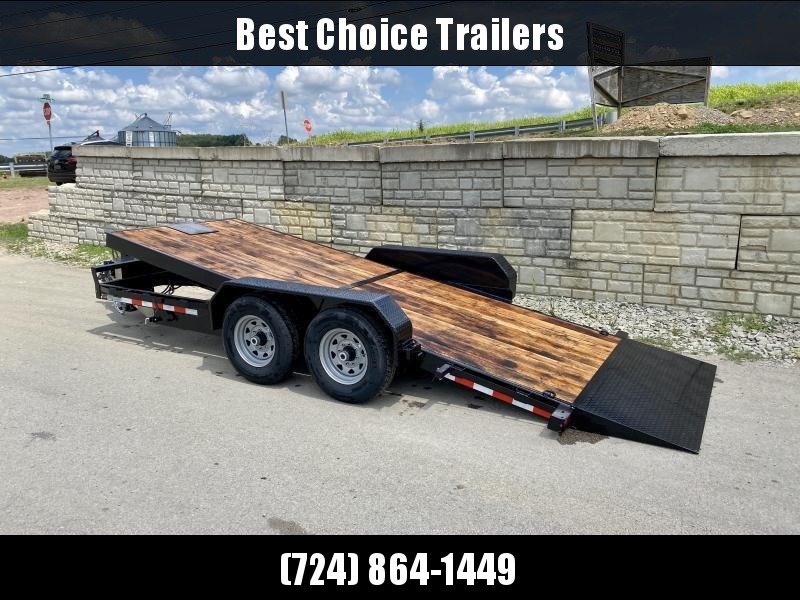

Hey Hoser. What size fuse to you recommend and where would I acquire such fuse? Here is the trailer I have btw.
