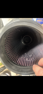

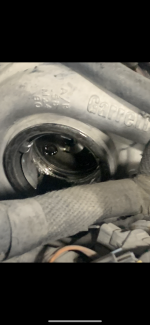

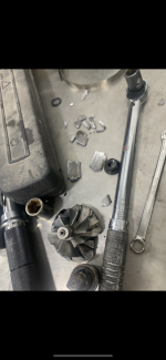

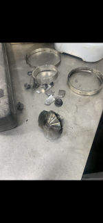

I blew my turbo up. It's been on for 10 years, tuned to 700rwhp, so it owes me nothing and was fantastic. I'd recommend them if they were still in operation. I have not even taken off the intake tube to look yet, but the dents protruding from the bend in my hot side intercooler pipe told me enough.
If it can be rebuilt, who could I send it to?
If it can't be rebuilt, who would you recommend for its replacement? I will probably want to do another large MM Vgt again.
Thanks!!

I will. I only took one quick one, while I was outside. I should have had the presence of mind to video the bellows of white smoke while I was pulling over on the highway! I ballooned the air filter, PVC reroute puked oil all over the ground, the dipstick popped out, and right after I turned it off white smoke was coming out of both the air filter and tailpipe for a few minutes.
