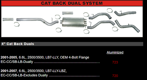

So i got it - finally the Bedliner is in the most amount removed
I like to have symmetrie on the Truck and so i am looking for a system with two rear end pipes
Let me know if anyone have a source for that
again a lost but doesnt matter as we want have rocksliders not these steps

I don't know if they are still available Flo~Pro and MBRP had them. I know other companies used to have them but they all seem to be discontinued an no longer available.
I see the FLo Pro kit and an open box MBRP kit on Ebay.

Thanks i will check it.
It is usual here in Germany that it start to discontinue parts after 10 years of release. So i am used in this issues

This used kit popped up near me. But I don't know how I would ship it to you.

Thanks 1FastBrick, i have also found on Ebay that offer
I cant open the used offer, but usually i need to long for checking that the most seller dont want wait this time
But I have to check the restrictions here for emission and noise before i can use a Kit from the USA
That mean i need from any Kit the technical specification and than i have to check if it will pass our roadapproval here.
i have learned in 40 years car and motorbike tuning that it is senseless to discuss with the authorities.
They follow just only the law - to talk before any tuning with them is the best way to have a cooperation with them
Beside this i have an export supplier so that i can buy parts by seller who dont ship to Germany.
95% of the Parts for our Chevy was bought in USA as here the most is not available or much more expensive.

Most aftermarket Duramax exhausts will be louder than stock. I remember that some people bought resonators and added them to their systems to knock down noise levels and drone. Not sure if any are still available anymore, though.

A nice sound is wellcome not loud but they are here very strict. Police can measure dB and if yours is to much the Truck will take immediatly of traffic. Not allow to drive just any mile. You need a towing truck to take him home. Additional high punishment fees and the truck need a new expensive roadapproval to got road licence again. Beside of course emmisioncontrol. This will control here every 2nd year in roadlicence during the technical test (also every 2nd year).
So we try to find a way for having dual stainless steel exhaust with stock specs but without loosing also power.
We failed in that case on the chevy. He got now stainless steel mufflers and the rest pipes in aluminized steel like stock condition.
Maybe it is also the only solution for the Sierra
