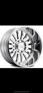

Dropped a couple bills on these today. Cali Off-road Summit’s. 20x10 -25. I’ve got some almost new 295/60 Toyo R/T’s to put on them. Hopefully the leveling kit turned up a bit is enough. Otherwise I’ll be looking at a Zone adventure series 3.5”or a 4-6” lift which I’m trying to avoid doing.

-25 diesel bro wheels.... ban him.... at least they ain't 14 wide... lol
Ha! Try looking for forged in even 20x12 nowadays. KG1 and Force laughed at me and said they were a special order. Everyone wants 22’s and bigger and -44 or -76. It’s ridiculous.
I wanted some flow forged XF wheels but they have nothing available. These came up on a one day sale 40% off so I jumped on them. Not forged but whatever-price was right. Should be delivered tomorrow.

These are gonna look sic. But I’ve never seen so many liars outside of our government as there is on custom offsets. There is no FN way guys are running this size on level kit only. I can barely clear the bumper and if I had all my fender it would rub hard.
So looks like I’m gonna have to install a lift.
