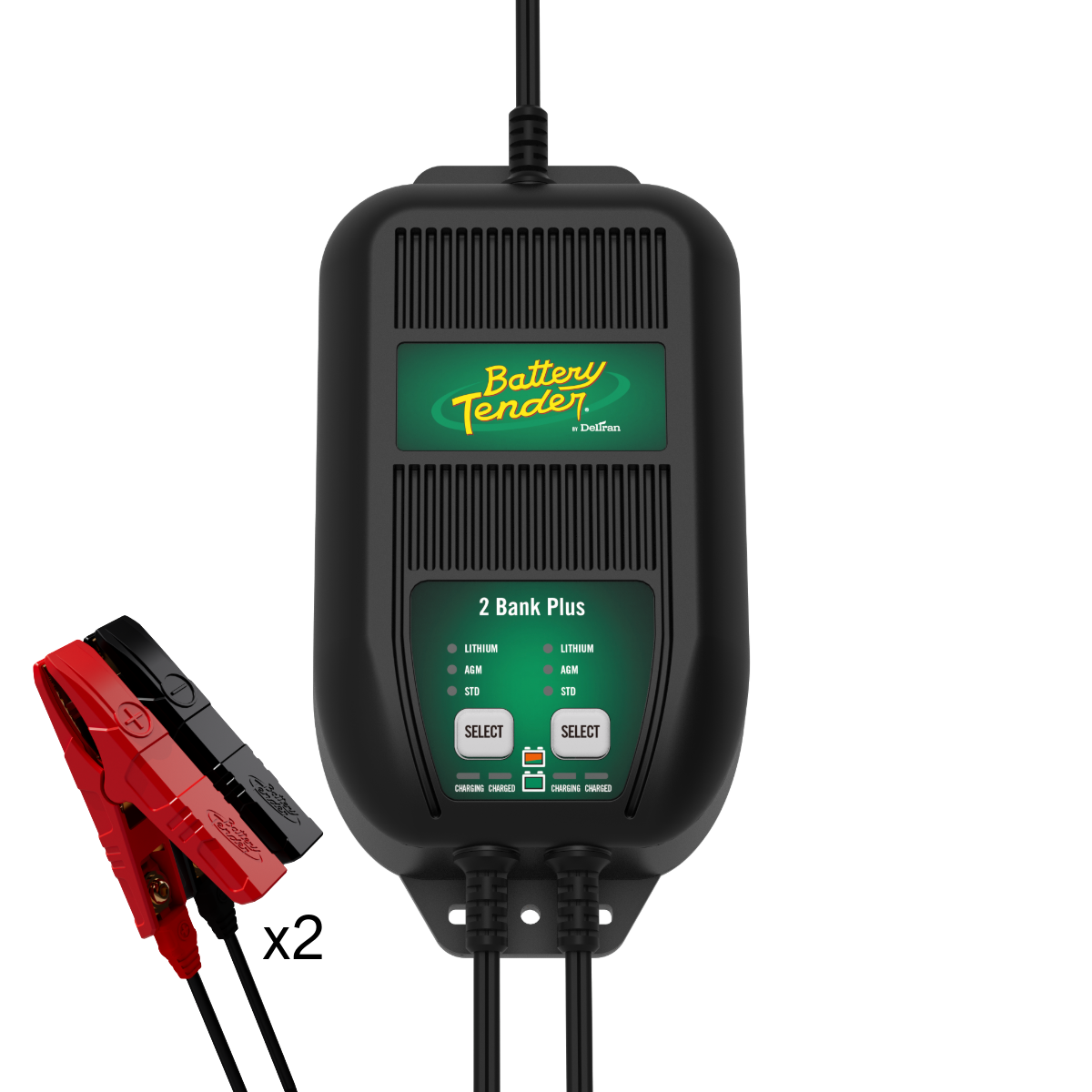

I would think that a battery tender brand with dual setup would be ideal. It puts out 1.25 amps to each battery. And being a maintainer, it will shut off when battery is charged.

I'm not so sure a two bank is needed or even wanted. our trucks have a single bank of two batteries connected in parallel. do you know if that charger can have it's outputs connected together? because that's what would happen if you put one on each battery

Unless you have a major parasitic draw, there's no reason a tender for a single battery won't work. Since they're tied together, they can be viewed as a single large battery.
I was thinking that as I have a 2 bank MinnKota onboard charger in my boat for the trolling motor batteries.

those have an isolator or switch to separate them, correct?
Now that I don’t know. I talked to a buddy who deals with batteries. He suggested a two bank maintainer with low amperage. He said 1.25 amps is good and if one battery is weaker it will get a full charge and not overcharge the other battery like a single would. I checked mine and one is 12.42 and the other is 12.54.

ok. yeah it sounds like they are isolated as each battery can have different voltages. in our trucks since they are connected they will have the same voltage. it would work good if Tom was thinking of disconnecting the batteries for storage. but not any advantage if left connected

Not sure if I threw you off talking about boat batteries but those voltages I posted are my truck batteries in the truck.
