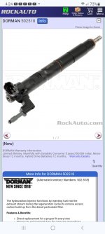

Sorry, it was a Dorman injector, not Duralast. I also replaced the fuel line with it. Here is the injectors I have changed with new ones...injector 3 (duralast), injector 8 (duralast)...both coded at dealership. Now injector 7 (dorman) not coded yet.
