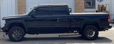

Well got some more things bolted on over the last week. I ordered 4 fittings from Holley (M12x1.5 -> 6AN 90) and all 4 had issues of which 3 were bagged wrong and one was missing an internal o-ring so it was very unstable/leaked. The truck is about 30min from starting so this is extremely aggravating......
Please ignore the bluetooth traction bar mounts, they're currently on my LLY chassis as it has been cannibalized for parts including the rear axle that is now under my LB7 as it had some real nice upgrades.

Well finally got it running. My dumb ass forgot it was an LBZ block and left the oil galley plug out where the oil pressure sensor was....................................... Needless to say 4qts of oil ended up on the ground when we were cranking for oil pressure. Obviously it's still a work in progress but this was a major milestone and a huge win for me.
I also did have a brand new GM LBZ rail pressure sensor fail on me and start leaking fluid through the connector so that was fun.
This video is maybe 5-10 seconds after it fired up. After realizing it was in VATS for a minute of cranking (thinking it just wouldn't prime the pump/rails) and doing a quick EFI relearn if popped off within 10-15 seconds. Cold idle it's 70-75psi at idle but who knows what that will turn into warm. If it's too low I'll weld up some of the ports on the relief since it has LML cooling nozzles in it.
