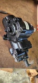

About 2 mo ago i finally rebuilt my stock OEM box on my 2010, 228k on the clock. Boy she was clean inside and all I did was adjust the input shaft shaft depth, install new seals (reason for removing it was leakyyyy) and slapped back in with new pitman arm/idler arm. Steering feels pretty tight, at least as tight as new i think. Needed a pressure line too. $27 seal kit, new fluid, and a few hours.

Got my Cardone box in from rock auto today. They have been out of stock. I kept checking everyday. Finally had one in stock. Hopefully this box holds up well.
