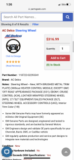

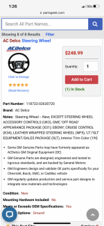

Just as the title states. I need help choosing a new oem steering wheel since mine is coming apart. The interior color code for my truck is ebony 19l. And I’m searching on parts geek. And am a little confused to which option I should pick to match what I currently have. I will put all the pictures below. One option says brushed metal. I’m not sure if I have that. Or just the plain ebony color. I’m thinking the one I need is the second seat geek picture.

According to the description, the first one is correct. You have option UK3 steering wheel controls. The second option listed is with out UK3 and if you zoom in you will see that the right hand side of that wheel does not have the button controls.
UK3 option is listed left column 3rd row up from the bottom on that RPO Sticker

Thank you, and damn I could of swore both had the buttons on either side of the steering wheel. Good catch.
