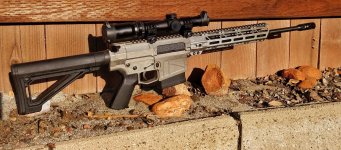

I swear the gold fades more and more every day. got to be the anodizing is self sealing the pores.
outside in the sun picture. see if any of you can spot what's missing from the rifle that is needed to operate properly.
Reactions: gmduramax
6,395
1,755
Are the gas block and gas tube missing. Hard to tell with the hand guard.
winner. now you can have a cookie
I'm actually waiting on a "lost" package that has my parts. this would be the 2nd time in a row that the gas tube would go missing. maybe a 3rd time will make it through. wonder if it has anything to do with the recent police changes that the big three shippers seem to have adopted for firearms
