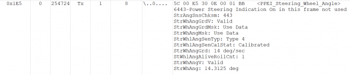

Hardware wise, we can test all this for $50. Some off the shelf hardware I've been playing with T87 mods. So I took a look at some LML chassis data, and found an EPS node that was spouting some steering angle data. That lead to a list of who it's Transmitting this data to. Along with a very long list of possible RX signals, most of which are brake or EBCM wheel speed related. So that migh be our missing link.
I wouldn't think a steering unit would require much data operate happily. Most likely some Speed, EBCM or BCM messages, not in the LBZ chassis. Take a little trial an error, but according to the CAN specs, that node will TX DTC messages and some others stuff to let us know if happy or not. Just need to feed it some crap, and see what it likes. Probably speaks OBDII also.
0x1E5 is only message I spotted it speaking on an 14 LML chassis from few weeks ago.
