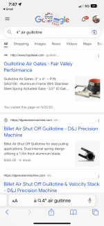

If you're fine with one on the air induction/suction side just look for a simple 4" air knife guillotine.
Google Link
