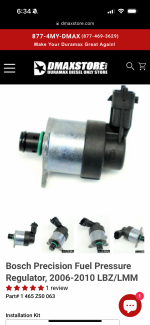

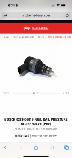

So the actual regulator on the cp3 is an lbz because I’m running fleeces PowerFlo 750.
But these are the ones you guys are referring too correct? Before I buy them. Anything else you guys would recommend or add? I don’t plan on taking it back to the guy who did the head gaskets. I have a hard time trusting him, even though that work turned out to be fine.

21,667
5,813
So you have a cp3 conversion? Honestly you need to diagnose the issue first before throwing parts at it. You could have a bad connection or no supply power or broke wires
